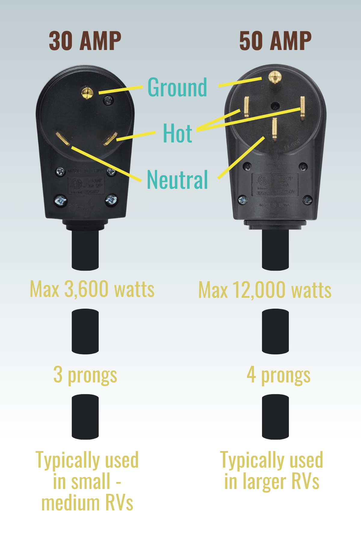

          I apologize in advance, but I’m completely new to this. How can I tell if my camper is 30 amp or 50 amp? I do have an adapter that looks a normal wall outlet plug, which I’ve been using at home.

              Welcome to the community, Glenn! No need to apologize. If your camper has a 3-prong plug its a 30-amp and if it has a 4-prong plug it’s a 50-amp. Here’s a pic of the difference:
              Difference-between-30-amp-and-50-amp-RV-plugs
              Here’s a link to an article for more information: https://camperfaqs.com/is-my-camper-30-or-50-amp

                  Looks liek I got a 30-amp. Thanks for your help! Great community here. I’m sure I’ll have more questions. lol
